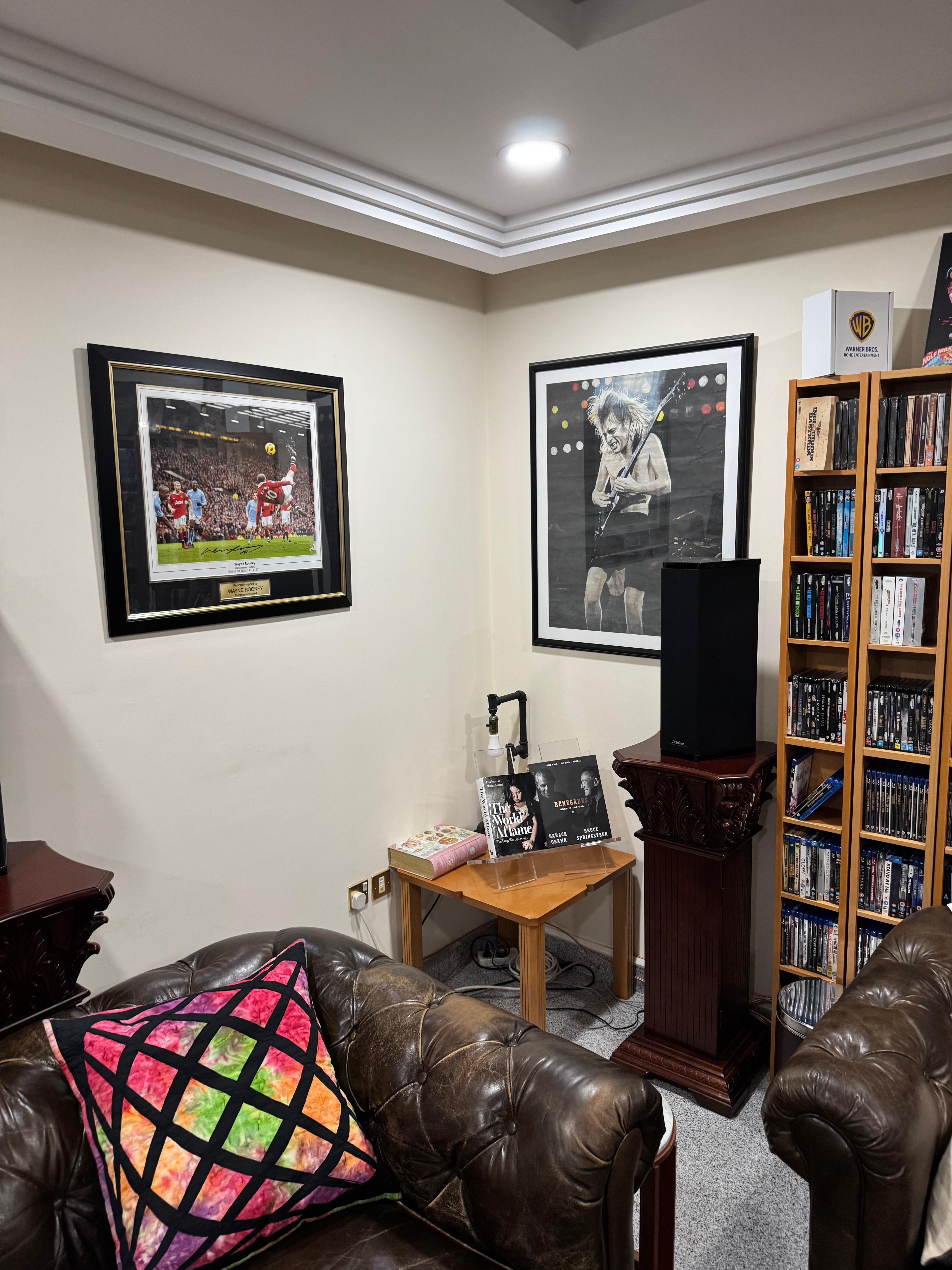

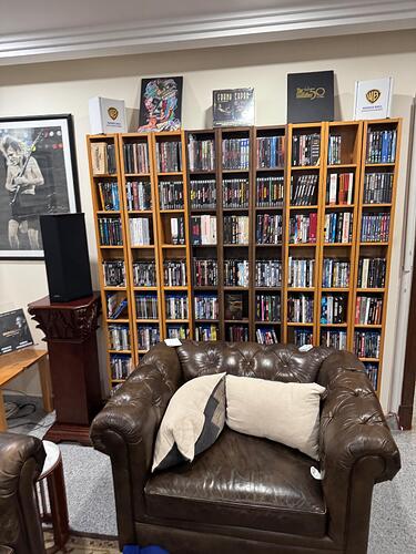

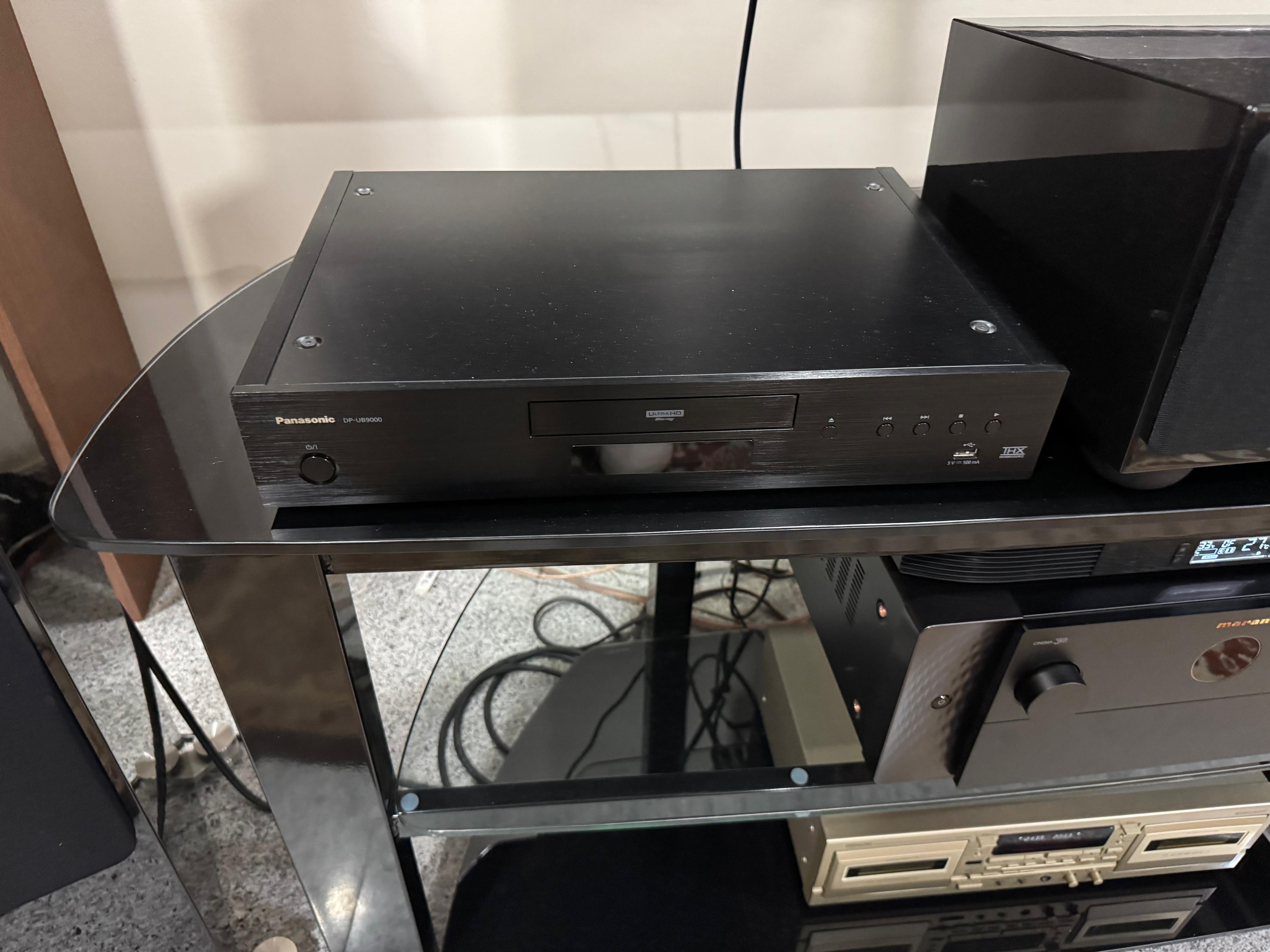

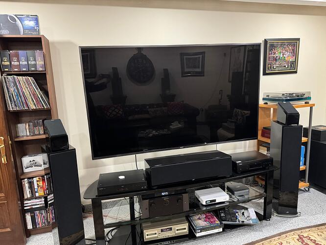

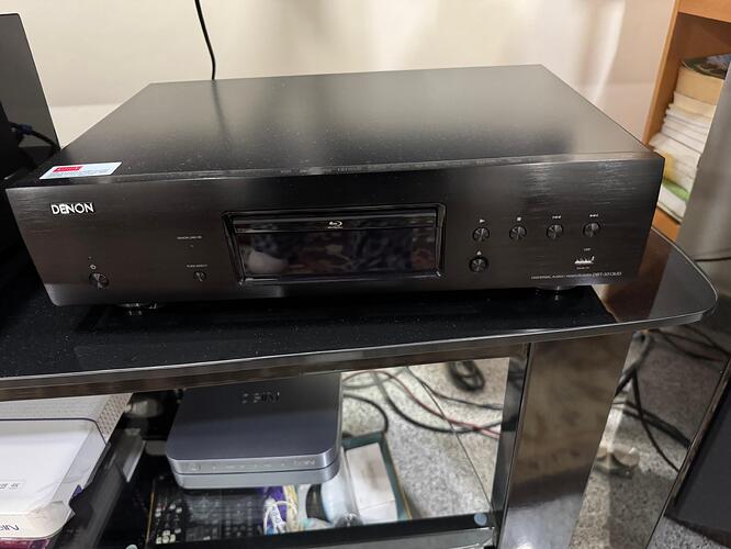

1- Just to give you an idea how how my setup is, the Denon DBT-3313UDCI drives my SACD collection as the Panasonic DP-UB9000 is not capable of playing SACD. The Marantz Cinema 30 drives the Turntable player. As you can see everyting is routed through the Marantz, hence to be able to to use the HD 800s for music, it seems I need to find a way to buypass the Marantz.
2- As you’ve indicated, for Movies and Sports, it won’t make much of a difference, I can connect the headphones directly to the Marantz Headphones jack and probably it won’t make a difference in sound watching movies or sports.
3- The 20% is what concerns me, I want to be able to enjoy the SACD and Movies Soundtrack and my good collection of records.
4- Would the Apple Dongle DAC makes a difference or I just need to jump directly to a DAC and Amp setup.
Here are few screenshots of my room if it may help.
Regards
