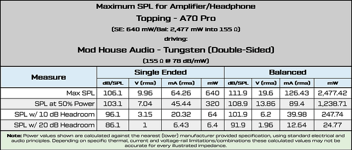

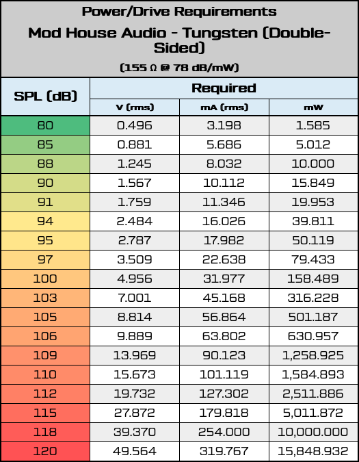

“Enough headroom” could mean almost anything. You have to take into account your average listening level, the output level of your source, the gain and maximum power of the amplifier, and finally how much headroom you consider to be enough.
First, here’s the raw power requirements for the Tungsten DS:
Assuming a balanced source, outputting at the input-limit of the A70 Pro, and balanced output into your headphones, you could expect the following from the A70 Pro:
If your source can’t manage 9.8Vrms (BAL) then you won’t get the rated power in low-gain, and in high-gain you need to ensure you stay at 2.0Vrms or below - which for balanced might require using attenuation on the source (normal BAL is 4.0Vrms [sometimes 4.4Vrms]), which can compromise dynamic range/SNR.
You’re looking at things like a Lyr+ or Jotunheim 2, to get into a similar power-delivery level at under $1,000. Maybe other options, though none come to mind presently.
I should probably add the Tungsten to the “standard impedance chart” for power delivery on my amplifier power tool, since it’s. such an outlier in terms of (lack of) efficiency/sensitivity.

I updated my tool, specifically the “Amplifier Power/Drive Reference” to include both the single and double-sided versions of the Tungsten in its output.
Bear in mind that since most manufacturers do not publish their voltage/current drive capabilities independently (typically just power by impedance), the indicated values are calculated and may not always be accurate (unless shown in green).
Thus an amplifier with very high current capability, but relatively small voltage swing, may run out of voltage before hitting the indicated power numbers (or vice versa) - yielding lower available power in that instance.

The tungsten have quite unique driving requirements in that they need a significant amount of voltage compared to other headphones. They don’t need all that much actual power or current (half the current of a Susvara for example), and so the challenge is not finding amps that can handle high current situations, but rather finding ones where the max voltage output is suitably high (and they have enough gain).
The problem is, amplifier power at 32 Ohm mostly just tells you about current, not voltage. To know the max voltage an amp can supply you ideally need a 300 Ohm power spec.
For most people listening around 85-90dB, you are probably going to want to look for amplifiers that can supply 20V output (1.3W @ 300 Ohm), and assuming you have a 4V output DAC, an amp with at least 14dB Gain.
This is a general application though. Those that listen quieter will be fine on amps with 10V output (0.33W @ 300 Ohm) or less, and those that listen louder or if you’re wanting to apply significant bass EQ will probably need to look for amps that can do 30-40V output (3.0-5.3W @ 300 Ohm).
