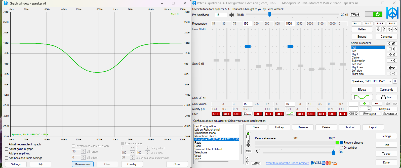

Update:
Hi all. I just wanted to share some more insight on these headphones. First I’d like to say is that they both respond incredibly well to EQ. I actually apply the same EQ settings to these headphones which I’ll attach to this post. I’d say it’s a strong V-Shaped EQ Profile but to me, they really do sound good with it! I like to use the M1570 with the velour pads they come with in the package over leather, as I love the feel and clarity it brings to the treble end without having a slight edge to it like the leather does. I still feel the M1570 has a wider soundstage, that both headphones are warm, with the M1060C Open Mod having more warmth is safe to say. I’ve come to hear more clarity and resolution with the M1570 so I feel the tonal tilt lends more towards the treble end. I feel if I had to pick one, it would probably be the M1060C Mod, especially when putting on the more comfortable headband and earpads, while also removing the closed wooden cups. I feel the narrower soundstage, additional warmth to the tonal balance while still having an exciting but non fatiguing treble response, lends to a very visceral sounding headphone, especially with todays rock and metal! That said, I think both headphones are great. But if I had to choose one it would very well have to be the Modified M1060C. With a little bit of work to modify them, it is absolutely worth it in the world of headphone listening. Both of these headphones are great.
