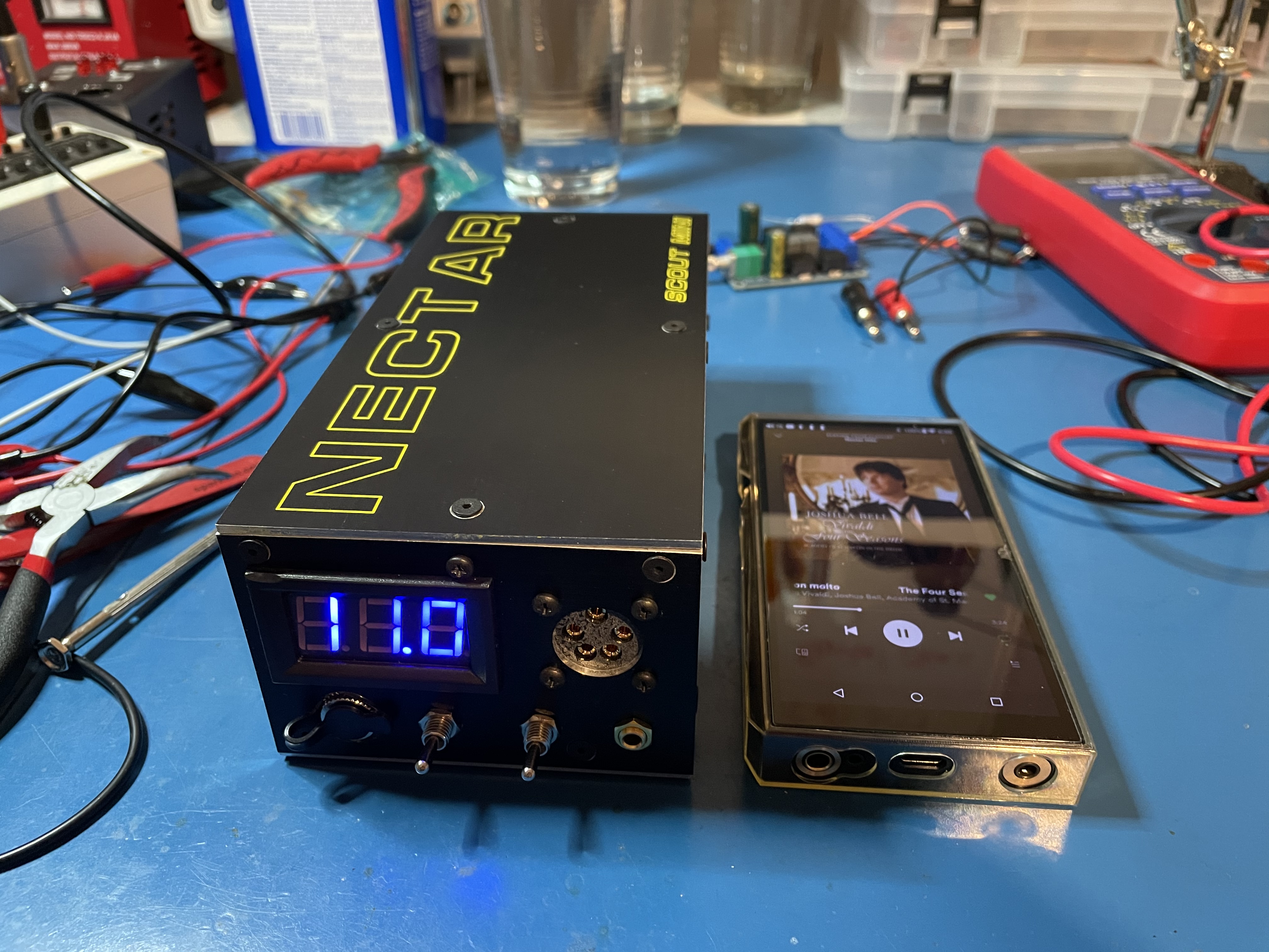

Very nice, but most people put the tube socket on top, not in the front.
Not a tube socket, front is the stax plug
That’s what I do for humor… My tube sockets have more pins.
Any teaser specs?
How much battery? Does it get warm? Is there a plug-in option?
Lol, tube in front is actually a cool idea, maybe double as a flash light or space heater.
Need to do a formal spec sheet but waiting on some parts to finalize it. Will build another with a different parts and spec that as well.
Battery life is about 6-8 hours. Rechargeable and battery is replaceable.
The THD+N for this mini is about 0.2%. I built a larger one with 0.02% THD but I prefer this smaller one. The larger xformer one extends to about 15kHz and this smaller one extends to closer to 20kHz. Bass is low on both down to 20Hz measured. Extension is based on about +-1.5dB. Both are quite loud. Bias is at 600V fixed and regulated. 4.7meg ballast resistor for the bias. 4.7k series resistors at the +- outputs.
Does not get warm. Draws about 0.11 Amps while listening.
I live life on the edge and suggest you put 4 active tubes upside down as feet for the amp.
LoL keep the ideas coming
Need to make the battery interchangeable. Like the battery on my GODOX electronic flash. If you could use an existing form factor like that, you could have a door to swap batteries, and people could use an external charger to keep spares ready. No re-inventing the wheel.
