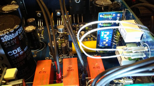

So, here’s a curiosity: As I started listening today and doing some casual listening to the HSA-1a and JOT R I decided to reset the attenuation to -10db from the -6db as delivered to me. (turns out I prefer the range I get to use with the volume control at -10db).
After I got the lid off I’m staring at it and something struck me as odd.
MY UNIT
TORQ’s UNIT
Looks like the little PC board with switches is installed backwards or the opposite of Torq’s?
It looks like the resistors and DIP switch block on the vertical board have been moved to the opposite side of it. The actual connections and components/placement are the same. So it is probably a change made for ease of access or assembly and won’t have audible/performance implications.
But yes, that is different to mine.
