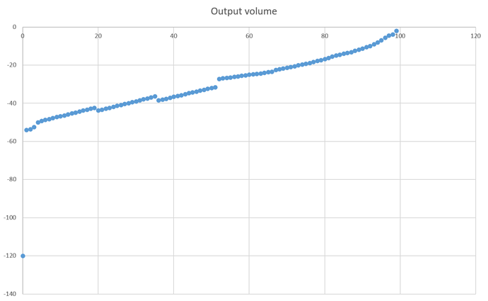

Yup! But it also happens between 19-25 (19 gets loud then volume drops until 25) and 30-35 (same thing) at least for me. This is all in med gain btw but this is what I’ve found to be inconsistent with my unit.
Soundnews reviewed the Soloist 3X and actually plotted a graph of the volume behavior:

Glad to know a replacement volume chip fixes this to some degree.
