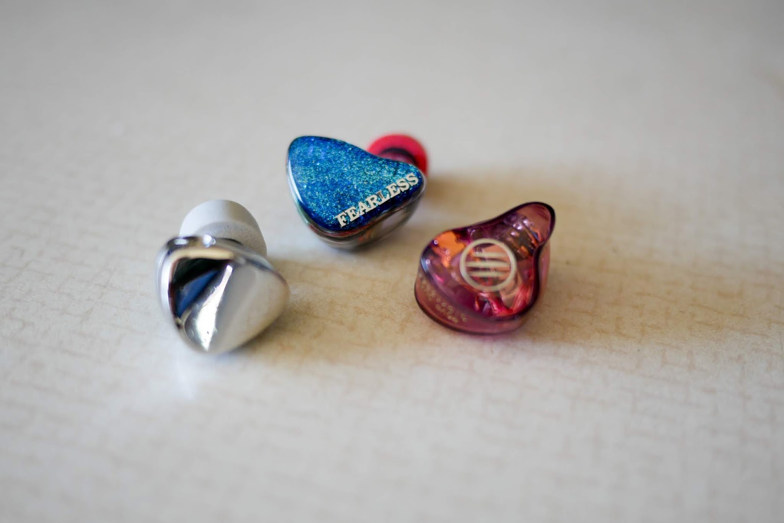

I never heard of Fearless Audio before until Lillian from Linsoul asked if I was interested in trying out their line of in-ear monitor earphones. It seems the company started several years ago in China doing custom in-ears and now are introducing a line of universal IEMs to the market. The first model I am listening to now is the Fearless S4.

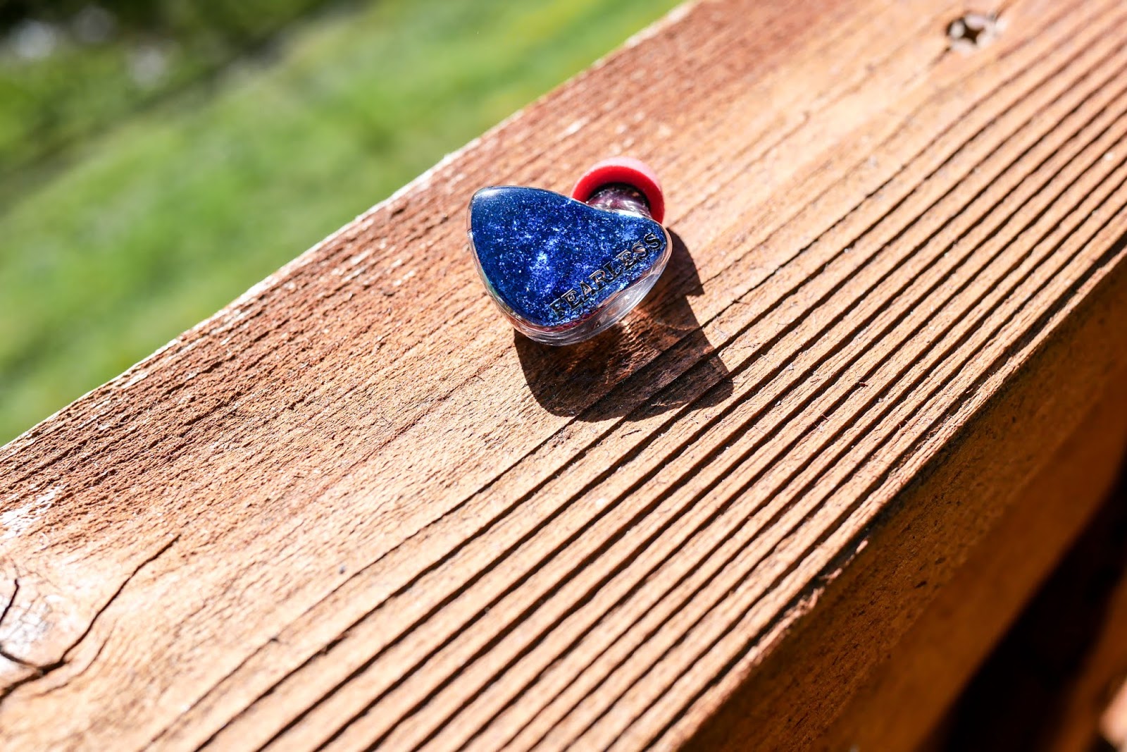

The S4 has 4 balanced armature drivers (BA) inside each molded shell. The drivers are Knowles brand drivers with 2 for bass, 1 for mids and 1 for treble. The IEM is rated at 114 dB/mW sensitivity with impedance of 32 ohms. The Fearless S4 starts at $289 for the basic model with basic color choices. Users can upgrade the faceplate and look for additional fees, as well as submit molds to use for a custom IEM version of this earphone.
As a disclaimer and as mentioned above, Linsoul provided me the Fearless S4 for review and this IEM is available on the Linsoul.com website with full customization options.

The S4 has a molded housing that’s not too dissimilar from some of the more recent premium IEMs out of China. It has a similar look to the BGVP DM6 and Tenhz T5, which I recently reviewed. I do find that the S4 becomes a little painful after some use – perhaps after about 30 minutes. Some days, I’ll find it very painful and need to take them out to let my ears relax and breathe, and other days, I can live through it. I am finding today as a day I can leave them in and let them sing to me, and that’s why I finally got around to writing this review.
