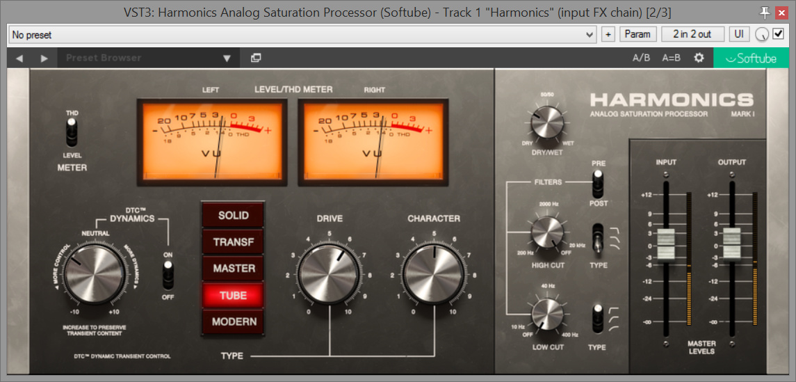

Thanks for your inputs. Saturation plugins are tricky. I’m currently trialing this one and spent some time tweaking the knobs:
The good thing about it is after you dial up your sound it’s just an on/off control. Everything has an “overdriven” character to it. Works great for songs from the 70s.
It’s cool but I’d never pay MSRP for it. The same argument goes for Pro-Q3. It’s undeniable it’s a killer plugin, but I’d rather purchase a new headphone instead given its price tag. I shall see soon how low this one can go when on sale.

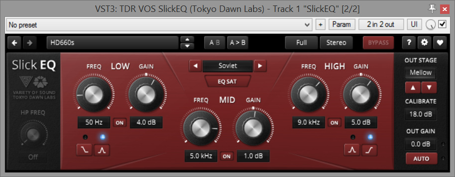

EQ-wise, I’ve been using this one (free):
I probably don’t need more than 3 knobs anyway.
