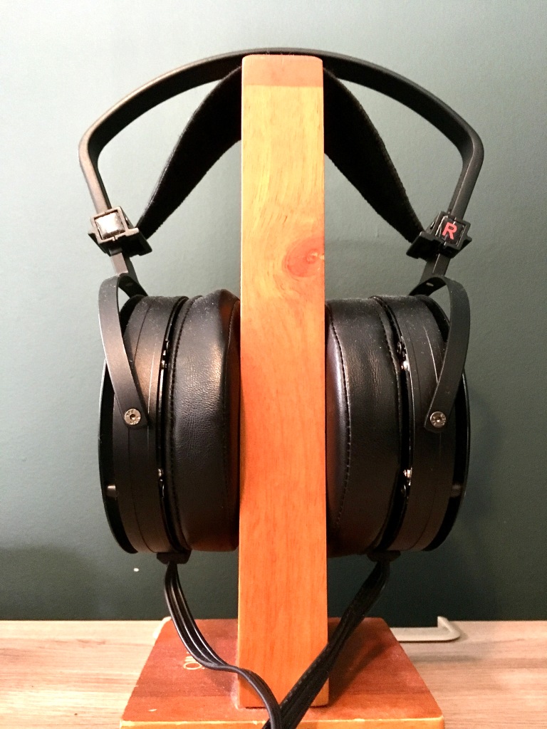

I recieved this intriguing headphone today after pretty much jumping in blind. Sometimes a headphone doesn’t gain much traction so you more or less just have to jump in, which is what I did. This post will primarily be early impressions but I also hope it can serve as a base of knowledge on this headphone in due time. The ES-1 Alpha is currently in early production and is therefore discounted by 20%. It costs about the same as an L700mk2 currently but will be more in line with 007’s price soon.
What the ES-1 Alpha is: an electrostatic headphone that has taken quite a bit of design language from the original Stax SR-Omega. There are 2 crucial differences, however.
  1. The stators are not mesh like on the Omega but rather an extremely thin more typical stator. At only .3mm thick it is substantially thinner than what Stax and other electrostat manufacturers use (typically 0.6-1mm)
  2. The ES-1 Alpha is made entirely out of aluminum with exception of the headband that is nylon. This means the headphone is heavy. I’ve not put in on a scale yet but I’m guessing north of 600 grams even without cable. Like bert reviews once said (about a completely unrelated headphone), These are big headphones.
So, first impressions after a couple of hours critically listening with one of the 2 pairs of pads this has available, I ordered both pads so I will compare them at some point but for now the pad attachment is too complex for my tiny brain to figure out.
When putting the ES-1 Alpha on my head and playing music there was one thing that struck me immediately: I’ve heard something very similar before, in the form of Stax SR-009S. Like the 009S it throws a huge stage and has exceptional imaging. It also has a slightly thin-sounding characteristic that I owe to some shout coupled with slight lower mid/bass recession.
That’s mostly it for my impressions, it sounds a lot like the 009S. If I were stax I’d be starting to be worried right now because between this and something like the L700 this is a total no-brainer to me. At least with the current pads (I believe these are the “darker” pads). I also neglected to mention the unboxing experience is really nice too. It comes in an untreated paulownia box with foam inserts. Not as nice as 009S’ box but certainly offers better protection and more stylish storage than the very cheap stax packaging.
Is it perfect? Far from it. But if you like the sound of estats I think this is shaping up to be a legitimate consideration. I still don’t think it will dethrone 007 for me, but we’ll see.

Follow up to my impressions from yesterday, I figured out the pad attachment (which is incredibly stupid I might add), and tried the stock pads. These are way worse quality leather than the “dark” pads for some reason, and I think the leather quality is frankly not good enough for a headphone costing this much, but I digress.
While the “dark” pads leaned slightly bright and had some shout the stock pads just turned this up to 11. Never in my life have I heard such a shouty bright mess. In my opinion the stock pads are borderline unlistenable due to extremely excessive shout, a lack of bass and offensive levels of midtreble. How the creator can call these “neutral” is beyond me, unless your perception of neutral lies close to DF with midrange boost. It does appear to maintain it’s excellent technical ability with these pads though, but I see no reason whatsoever to use these over the “dark” pads. They are lower quality, way worse sounding and less comfortable too. I forced myself to listen for about 10 minutes but couldn’t do anymore, nothing sounded good.
I also tried 007 pads, both mk2.5 and mk2.9 pads. The 2.5 pads had less shout than the stock pads but more than the “dark” pads to my ears, they also had quite a bit of sibilance but added a little to the bass impact (but not quantity) compared to the “dark” pads. 2.9 on the other hand were quite nice and my second favorite after the “dark” pads, they still had some shout but not any worse than the “dark” pads, these pads also slammed the most, even if this headphone doesn’t really slam to begin with. Soundstage felt somewhat more compressed, however, and the midtreble treble was slightly lower than what I prefer.
In the end it seems like the “dark” pads are what I would consider most ideal for this headphone so far. Ideally you’d have a similar pad that doesn’t have the shout but I figure I can always EQ that out, since there isn’t anything in particular otherwise that bothers me about these pads.

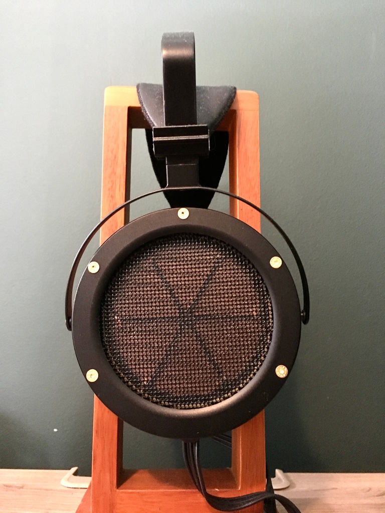

The ES-1a is far more interesting. It is the first (and only) headphone of the one-man venture ESLabs. The man behind it (he goes under bwck2000 on various forums) is someone who appears to have a lot of knowledge on electrostats, he even offers a repair service and can tout having serviced even an original SR-Omega and HE90. The ES-1a is heavily inspired by the SR-Omega in terms of the exterior.
ES-1a uses a pure copper stator that is only 0.3mm thick and appears to be quite a bit more open than the stax counterparts. According to the ESLabs website the idea is to have a normal stator that mimicks the characteristics of mesh stators (which SR-Omega and SR-X MK1 used). To put the 0.3mm stator thickness in perspective all stax stators are to my knowledge 1mm thick.
A brief description of ES-1a
ES-1a is a slightly shouty and slightly bright leaning headphone. It sounds more or less flat until right below 1KHz where it starts to rise a bit. I hear it as reaching a peak of about 3dB at about 1.5KHz. In other words it is noticeably forward in this range but I don’t feel a need to EQ it, though I will probably do so anyway. After the shout peak it drops off a bit, I hear the range from 2-4k as about 2-3dB below my percieved neutral. It has a big hole at 5Khz that I can’t hear too well in normal listening but is very audible when doing a sine sweep. I’m guessing it’s narrow enough that listening is not very meaningfully impacted. Moving into the treble it elevates a bit, personally I think the SR-007 has a very spot on 6-15Khz range (my hearing threshold) but the ES-1a has a similarly smooth treble with just a touch more energy. Overall the headphone is very smooth sounding with no obvious huge peaks.
Build and comfort
ES-1a is a big headphone, it weighs above 600 grams without cable (necklets be wary). The cups are machined from aluminum as is the yokes. The headband is a recreation of the SR-Lambda/SR-Omega headband but it appears the material used is nylon rather than the plastic stax used. It feels quite nice. The ES-1a has 2 different pairs of pads available, stock pads and «dark» pads. I am reviewing the dark pads here because I don’t find the stock pads very listenable in comparison. Stock pad leather doesn’t feel very good quality but the construction seems fine. Dark pads are made in a completely different leather that is much, much nicer. Some of the best earpads I have tried. Clamp is pretty low but you definitely feel the headphone on your head due to the weight. I can wear this for 8+ hours no problem though.
There are a few concerns/small notes about build though. First is strain relief. It seems cool but I’m not sure how much strain it is actually relieving, luckily Stax cables (which this uses) are very sturdy. Second is the pad attachment, this uses a similar design to SR-Omega where the pads are fastened to a plate and then attached with rivets, this is a very tiresome operation to go through every time you want to change pads, although it certainly is better than 009/S pad attachment. Third is the headband, the material is very nice but it has a solid piece going through it to stiffen it up a bit (think something like the Hifiman Arya headstrap). Which makes it feel not quite as nice as it could have been, but I am nitpicking.

Got these in for review and possibly a purchase, few hours in and I’m enjoying them so far, a touch intimate in comparison to 009 but really lovely non the less!
I’ll also mention if you’d like a chance to hear this headphone and you have an eStat system already put together please reach out to me! I am helping organize a US tour for this tho I will not be keeping this unit after it’s concluded.
First and foremost I want to thank the Team at ES Lab for giving my self the chance to hear this headphone! While minimal, the overall presentation in person is stunningly polished. The grain on the wood storage box has both a nice feel and look to it, there’s even a pair of wood wings for the outer face of the cup which make the headphone lighter.
Additionally there are two sets of pads, a “dark” pad with a fabric center and another set of pads without the fabric. For this review the Dark Pads were used as they removed some mid-range etch at the expense of just a little top end energy.
