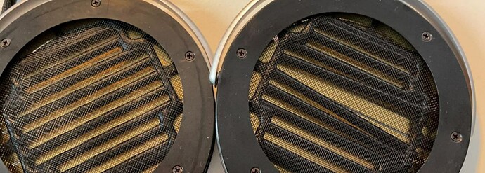

Can you share a photo of your susvara?
Maybe also a close up of the outside grilles and inside cups, if possible with a light source enabling to see the driver.
I am just wondering if there is some kind of filter on the outside or inside. I have never heard a Susvara in person but I know that Hifiman like to make silent revisions now and again, just wondering if there is some kind of dust cover or something on yours that’s not on the other(s).
This is actualy a good call. for a little bit there they had some with magnet issues that would certainly have changed the signature. If you look at the magnet structures all of the lines should be parallel. If they form a V anywhere you should RMA the unit.
First I’ve heard of the magnet issues. Any internal shots or pics of drivers suffering from this?

Left is what all 4 magnets should look like. Right is the messed up ones. Seems lkke it was one specific batch that made it past qc a while back
“made past QC” on a $6000 headphone… :rofl:
I mean, i dont think ive ever seen someone claim hifiman has even an acveptable level of qc…
