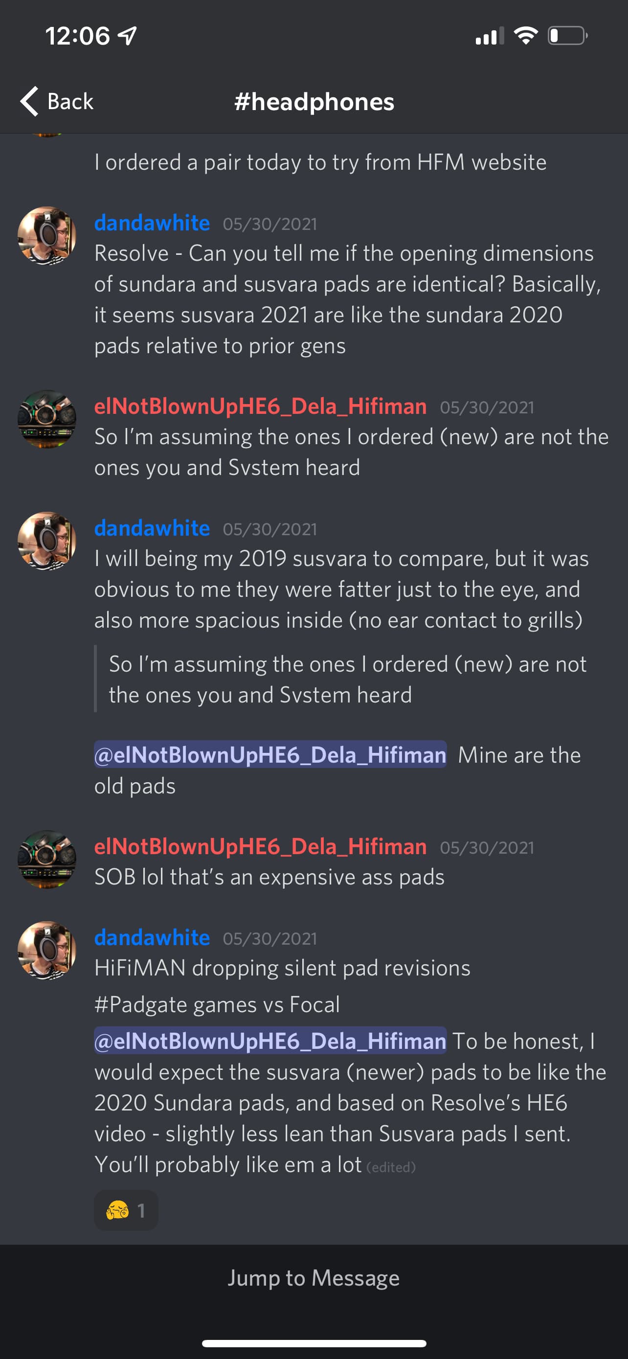

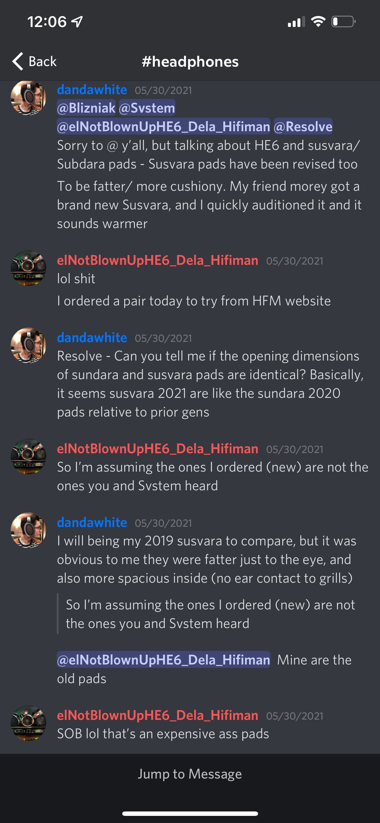

Thought I’d log in back to the forums and see if this was confirmed by others since I just got new stock pads from warranty yesterday and they do yield a different sound in my findings. I am unsure if Hifiman has confirmed new pad revisions, so I’ll use the term variants to address the two pads below for now.
To sorta preface, I’ve always wondered this because I’ve seen Crinacle’s Susvara measurements and they measure quite a bit different in the midrange and upper midrange/lower treble (from my understanding of his rig and mine on MiniDSP EARS). I just tossed it up to possibly not having hands-on experience with his rig or unit variances. My suspicions of potential variants sprung up again as I see that he’s measured 2 units that differ in the midrange to upper midrange/lower treble. Way too much to be just unit variances in my opinion, or if it is, it’s terrible QC.
Well, I got the new pads yesterday and took a listen and definitely heard a difference in the upper midrange. Here are my findings:
In more subjective findings:
Here are some measurements in addition to my subjective findings:
Note: The “old” earpad variants I received were used only a couple of times after a previous warranty replacement so they have little to no wear.
Measured on a MiniDSP EARS. HPN compensation. Left channel at 90 db. The 3-5 kHz region on the MiniDSP EARS measured on most if not all headphones is inaccurate. The MiniDSP EARS is also not accurate at measuring the treble region though it does provide a bit of insight if overlaid with another headphone’s response. I typically identify dips and peaks in the treble by ear with a tone generator - how reliable one thinks that may be is how much faith they have in my ears. …which might not be a lot understandably. ** Remember, only compare these measurements to headphones made on the same system (MiniDSP EARS) and the same compensation. In this case, there is the HEQ compensation (sorta Harman-eque IIRC), the HPN compensation (sorta diffuse field IIRC), and raw measurements (no compensation applied). Do NOT compare these measurements to headphones made on a different measuring system or you may misinterpret the comparison.
Here are my findings regarding the physical differences of the two earpads:
Here are pictures of the two earpads (left - older variant, right - newer variant):
I guess to sort of close off my findings, I think the differences in sound are due to an earpad revision. The difference in sound is too big for me to think it’s just earpad variation. The physical differences in the two different earpads seem more intentional than not. If I may reference my impressions post on Reddit 2 years back, I mentioned that I really did not like the stock tuning of the Susvara with its huge hole around 1.5 kHz and then the rise to 4 kHz. I thought the midrange tuning was really wonky. I swapped the pads with some old Beyerdynamic(?) pads that is closer to my preference and am still using the Susvara with those pads 2+ years later. At the end of said post, I said, “Not sure if anyone from Hifiman will ever see this but I would LOVE if they could revise the pads to make them a tiny bit wider and deeper at the back (by 2-3 mm or so) and with exterior perforations to improve the tonal balance in the midrange. I think it’d be a pretty killer headphone out of the box if that happens.” I don’t think anyone from Hifiman read my post being a random nobody, but it does seem my plead for revised earpads has been granted to at least me (with much better solutions to my pad suggestion regarding perforating the exterior).
In my opinion, this new pad variant yields a better and more balanced sound.
