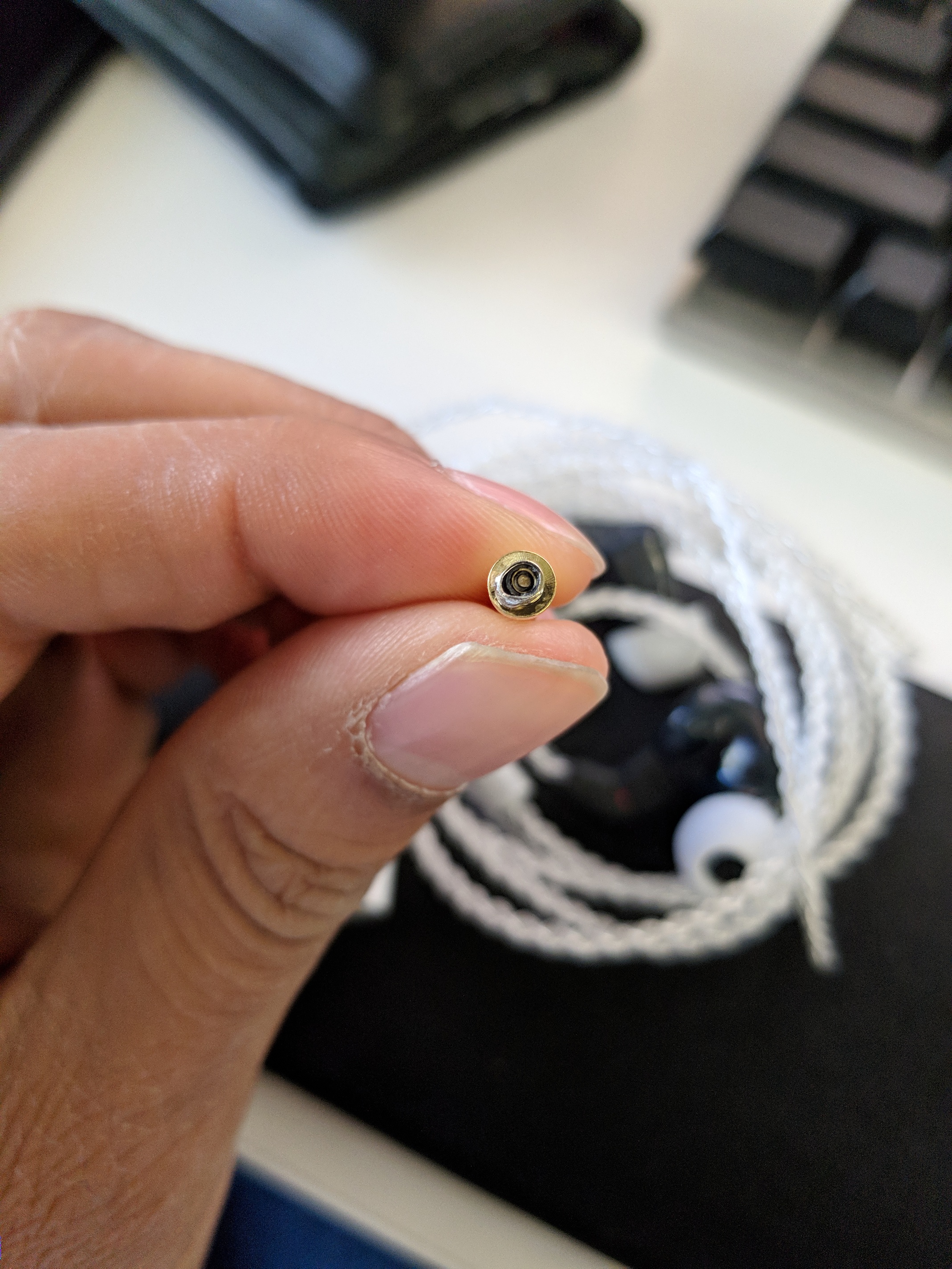

So this just happened to my cable:
Had it plugged into my phone, which was in my pocket as I got into the car. Cable snagged on the seat or something, and Bam. Looks like it’s terminated using plastic to house the connector, which is pretty weak. Good thing I have a null audio cable on the way. Guess I won’t be ABing the cables…
Any way I can reterminate that?
Ouch, my condolences. Just as an aside, are you able to order another cable from Massdrop? When I got my Massdrop Plus iem’s I bought the extra balanced cable and wouldn’t mind another. I bet they don’t sell them separately. Anyhow good luck and I hope you like your new cable.
-Paul-
Yup it’ll be like a 5 min job just get a new 3.5mm plug and solder it in.
Nice. I do have a soldering iron from my Keyboard building times, so that can work. Is it easy to remove the current one, usually?
Don’t think I can order the cable separately. :confused: I also don’t have any balanced dacs or amps in my chain, so yeah.
Yup just take some scissors and snip it off. Then you’re gonna have to remove some of the shielding from the wires and solder them in. You probably won’t know which wire goes to which terminals so you’re going to have to do some trial and error. I’m still in the process of making my cable making guide because I wanted to have as many connectors as I can before publishing it, but I can try to make a .gif today of the process.
And yup that soldering iron should be fine
