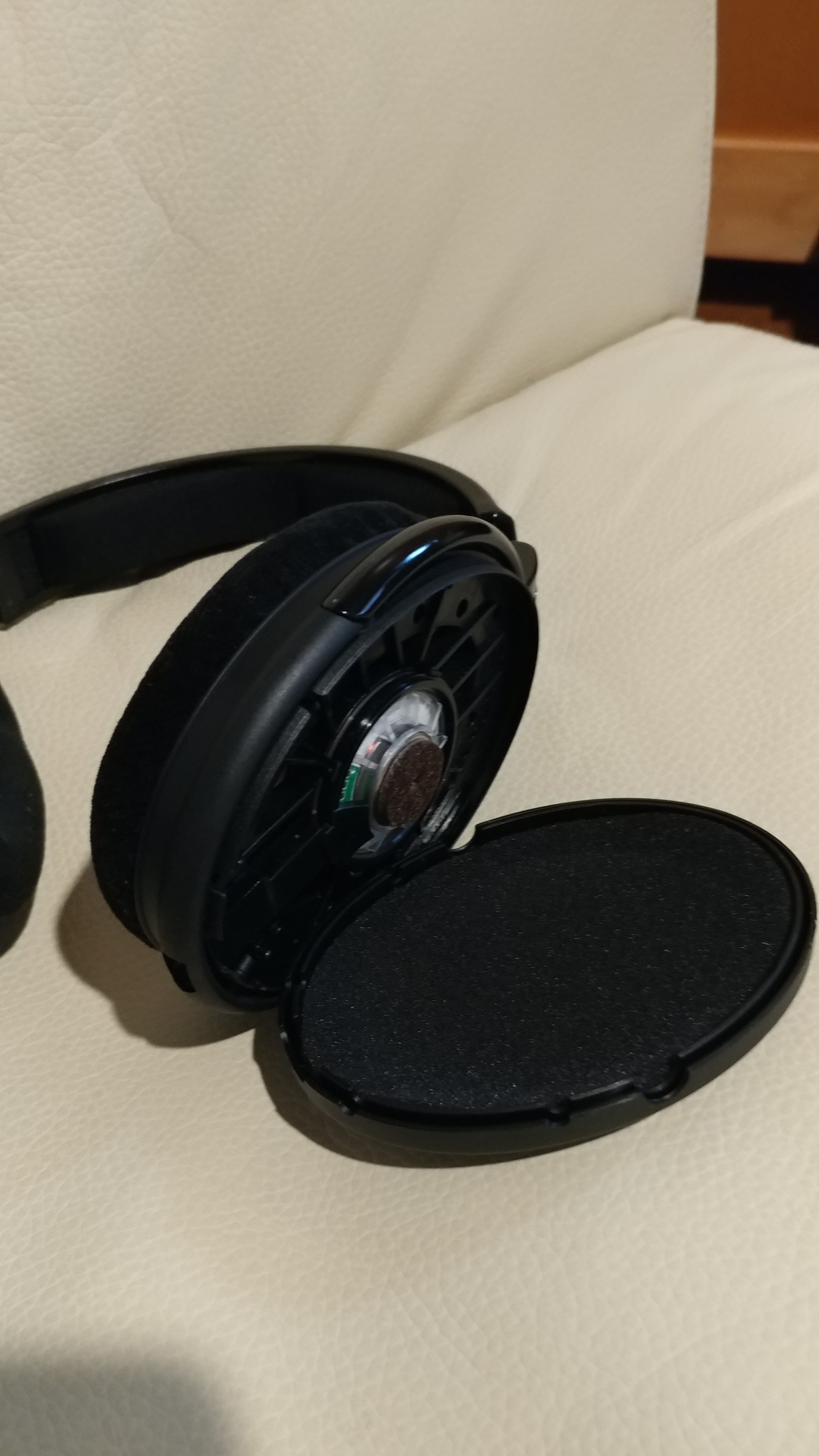

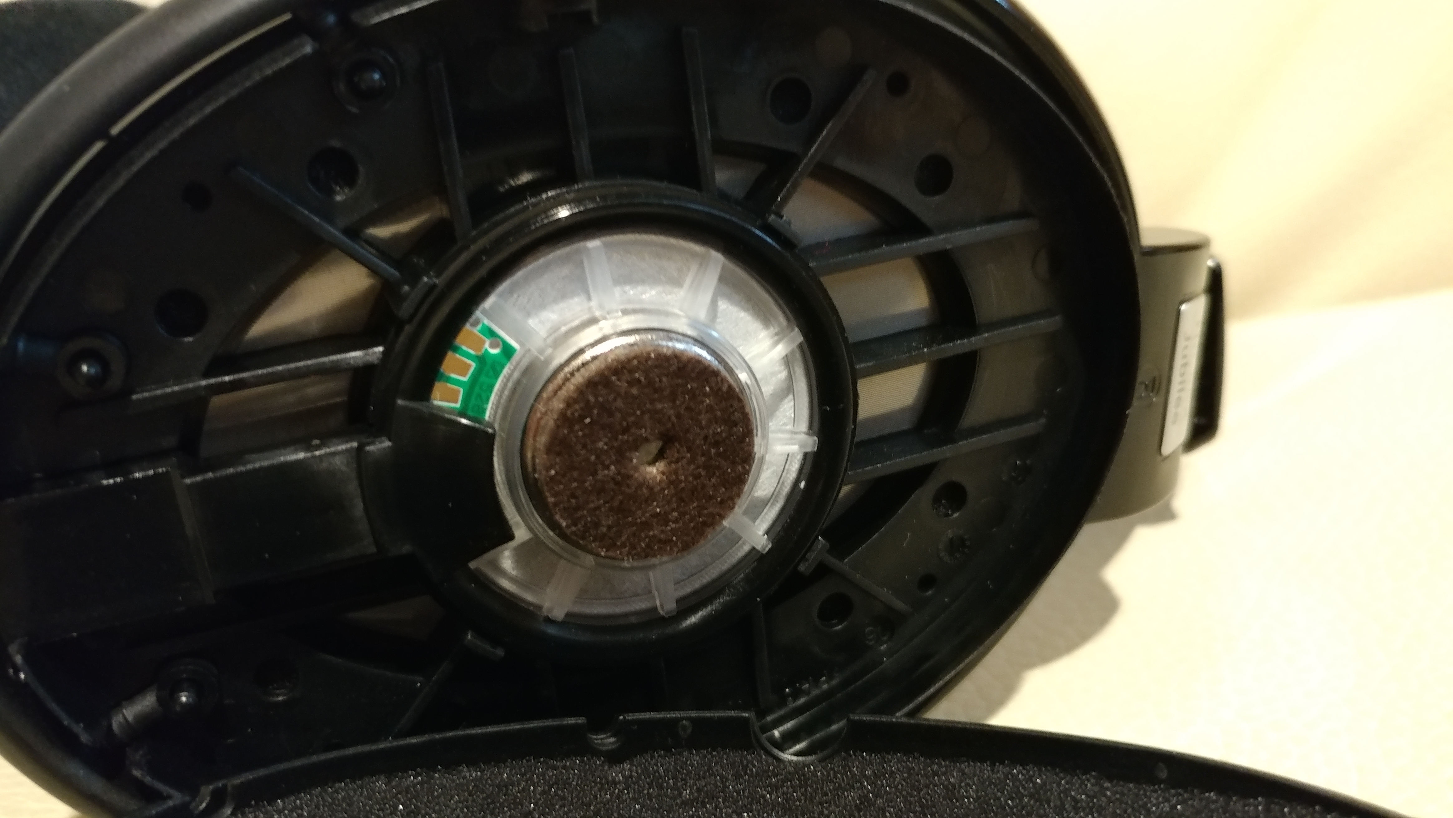

  1. Buy some 3/4 inch self-adhesive felt furniture pads. I used these. Note - thickness matters.
  2. Drill or punch a 3mm hole in the middle. Go slightly smaller in 0.5mm increments to get less bass/more treble, or bigger for the opposite effect.
  3. Remove the cables and remove the outer cages by hand, starting by prying off at the top (it helps to have fingernails)
20190202_161755
20190202_161806
  1. Adhere the felt pads to the back of the magnets
  1. Replace the cages. When you do so, keep the stock foam. Despite what a famous YouTube reviewer said, removing it has no effect on the sound, and it also allows dust into the driver.
Enjoy!

I finally got around to opening up the HD58X today. Have plenty of furniture felt in the garage and starting hacking away at it. I think I made my hole size about 4mm. It’s not very clean cut though as furries are cover parts of the hole. Will have to measure it a little later.

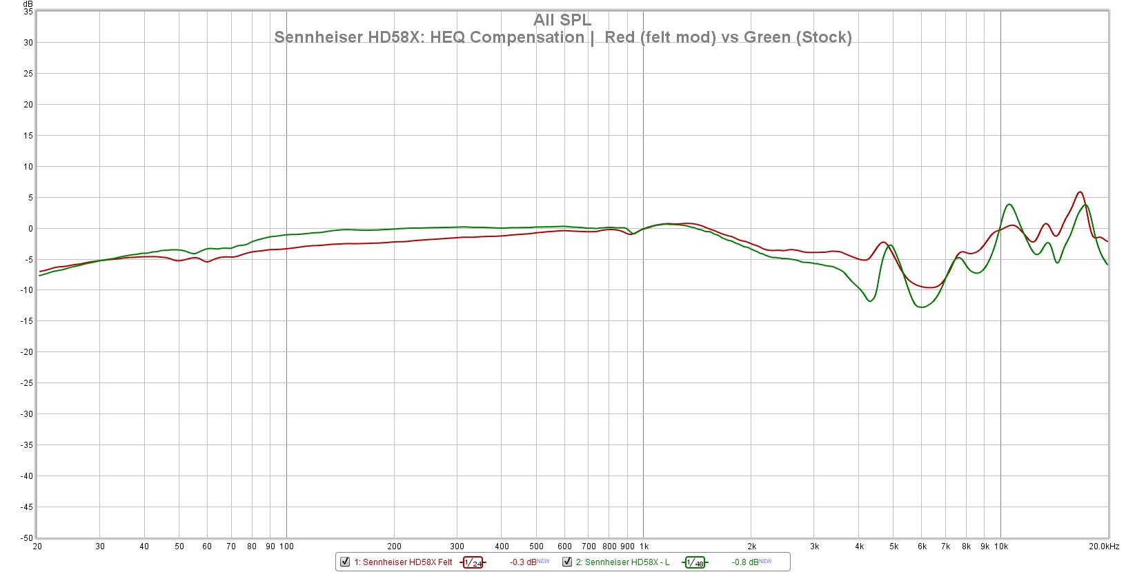

I wrote my review for this finally on my blog. In general, I do like it. It’s not my favorite headphone but at the price they are offered at, it’s quite good and mostly coherent. I didn’t like the uneven treble but that can be fixed mostly with the simple mod mentioned above. The rolled-off sub-bass was expected and not the end of the world. I also used REW to EQ it last night and the results are excellent.

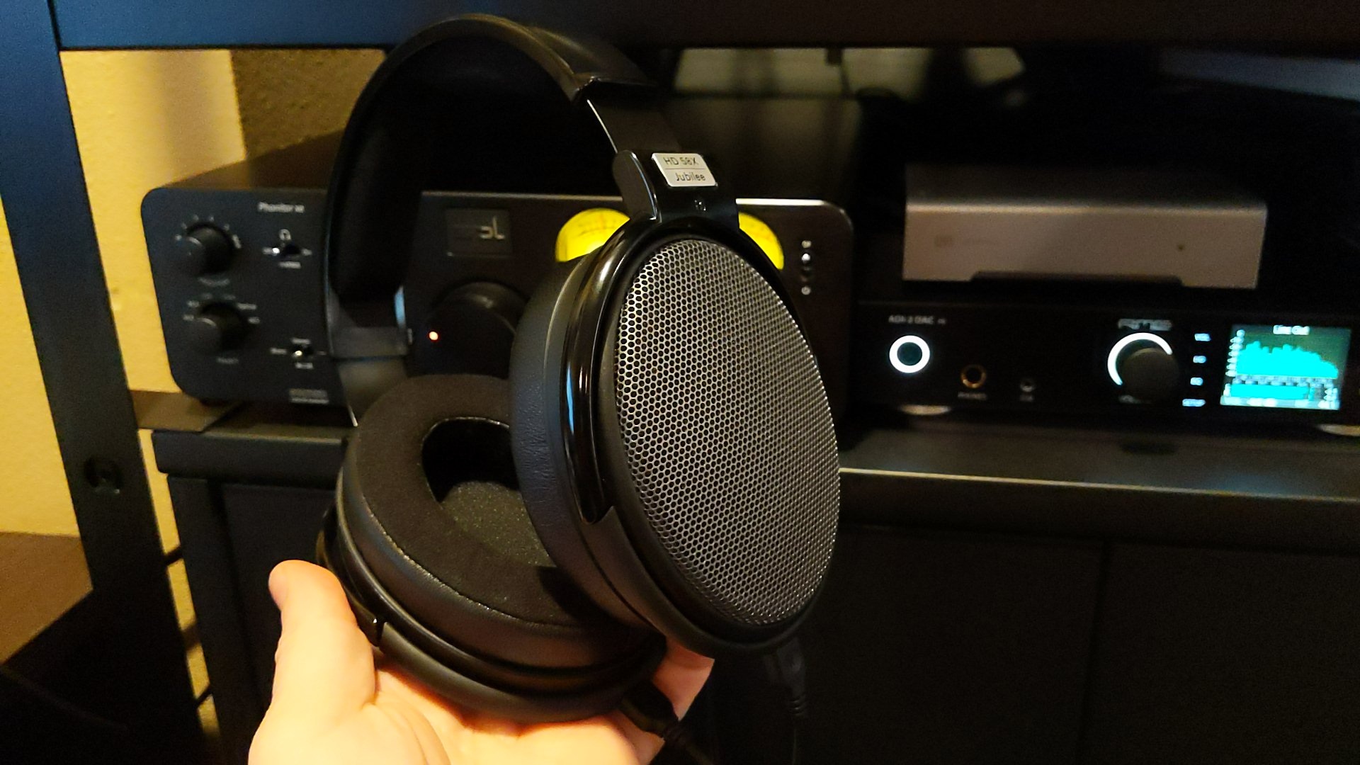

Here is a picture of the 58X with elite hybrid pads on them.
How is the comfort compared to the original pads?
More plush…but they add pressure at the same time due to being thicker pads…this can be alleviated by slowly flexing the band away from the cups until it fits your preference.
Yep. I did that when I first got them. I set a couple of hard cover books between the pads and let them sit for a few days. Helped the clamping but I find the stock pads to be too stiff.
Based on my experience with Yaxi, the new pads should improve the experience. The other question will be if they affect the sound. I’ll post next month when I get them.
The Elite Hybrids definitely alter the sound. I find them more lively with the pad swap. I also have the Dekoni Elite Velour and Fenestrated Sheepskin pads. They all have affects to the sound but usually just, still very noticeable though.
