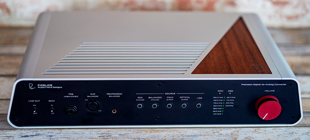

WoW! Looking forward to your thoughts/review on this pair!
It’ll likely come a bit faster than most (though I’ve already reviewed the SR1a themselves, here).
I am actually liking that look of the volume control…nice contrast!
That’s not for contrast, it’s simple heat. The knob gets RED HOT from the power required to drive the headphones.
