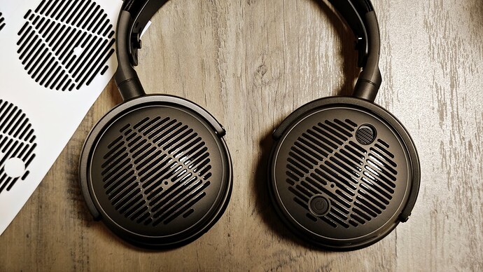

Customizing my new Audeze Maxwell to match the signature look of the LCD series. I really miss my LCD-2C — one of the best-looking headphones back then. Just added a UV DTF sticker to the Maxwell to look alike.
those are cool, where did you find them?
Ohhh I drew it and get them printed. Thanks.
Oh those are slick. The next step is to print a wood pattern and run it around the cups :smile:
Thanks…haha…good idea.
