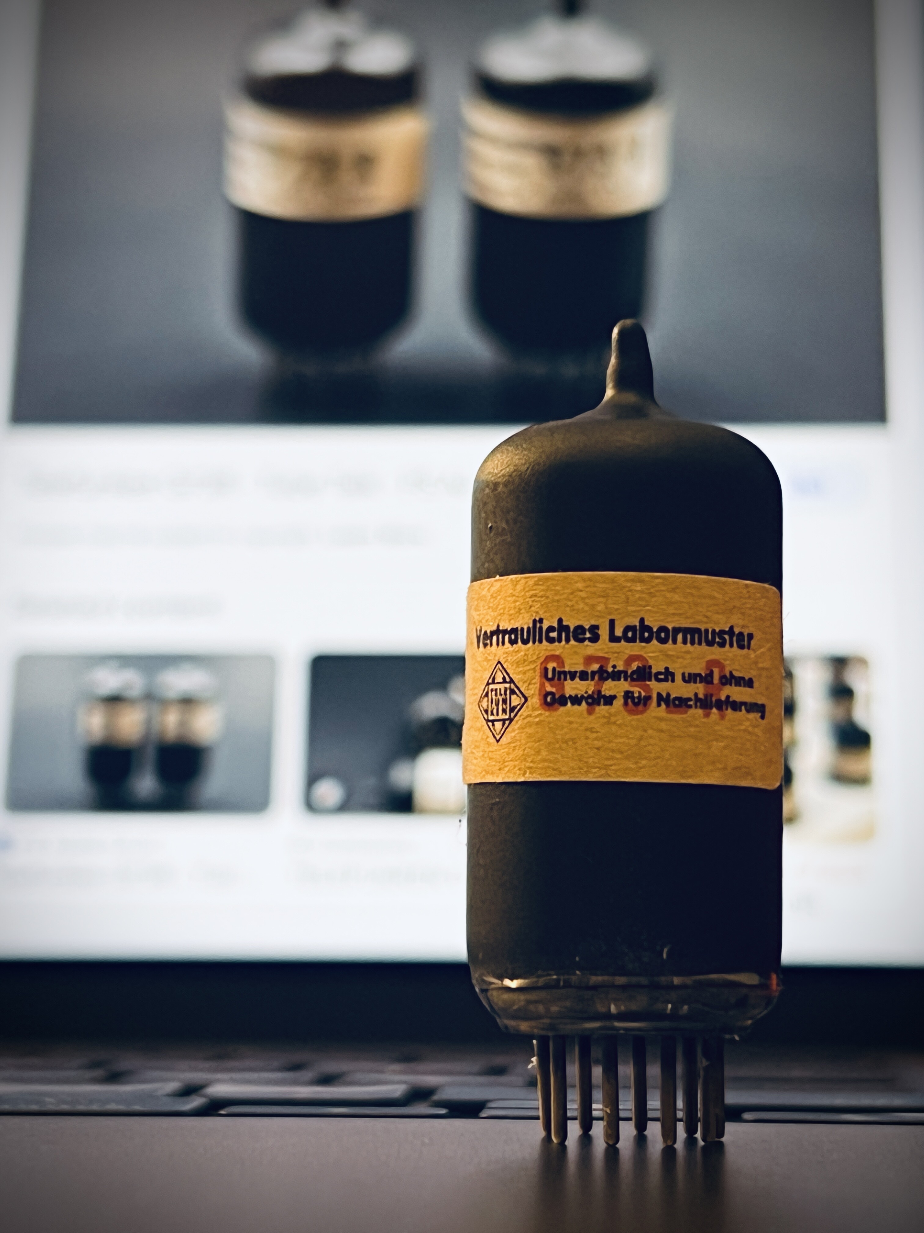

Thanks to the tube gurus here, this special tube arrived. And brought the Nautilus to a new level.
Damn. Damn damn.
What tube is that? I’ve never seen a tube that looks like that before.
I’m not the owner, but I think it’s the Telefunken G73R.
Upcoming review on the bottom box…
